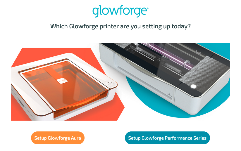

- Choose the type of printer you would like to set up.
- You’ll see the Unboxing Your Glowforge page. If you've already unboxed and set up your Glowforge, you can click through to continue to the Wi-Fi Setup step. This will open the Connect Your Glowforge to Wi-Fi page.

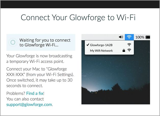

- Make sure your Glowforge is on, and the button is glowing a teal color. If it isn’t, then press and hold the button at least ten seconds, until it glows teal. Then on the setup page, click Continue.

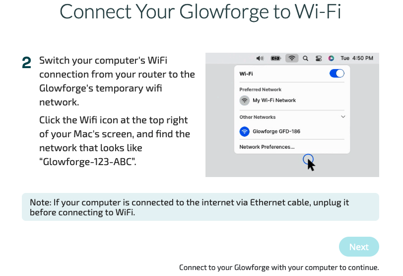

- On the page, you will see that your Glowforge is now broadcasting a temporary Wi-Fi access point. On your computer or device, go to your Wi-Fi settings and select the Glowforge access point.
You’ll be disconnected from the Internet for a moment until you finish the rest of the setup process.

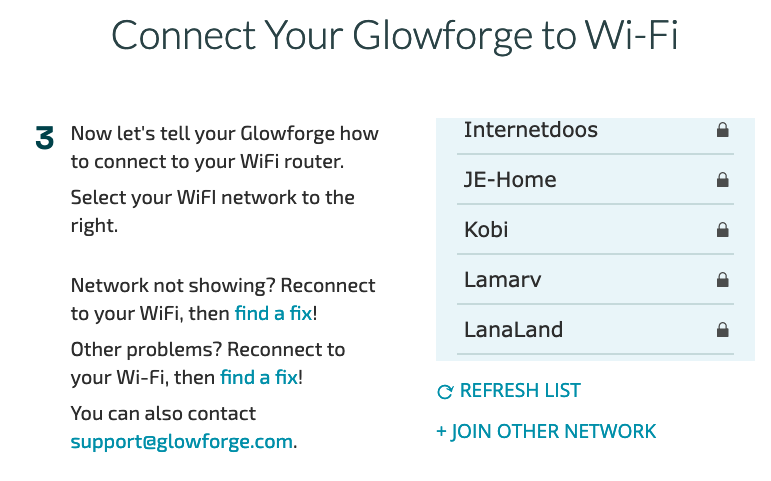

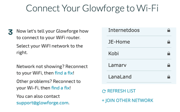

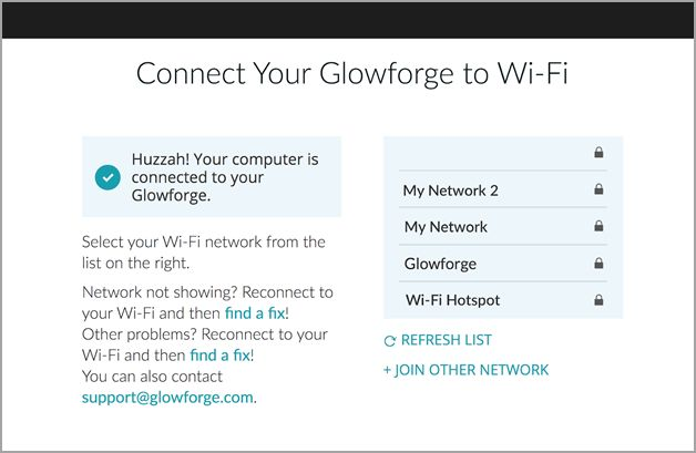

- Once you see the message that your computer or device is connected to your Glowforge, in the list in your browser, select the Wi-Fi network that you want to use. If prompted, enter the password for your network.
NOTES:
- Be sure to select your Wi-Fi network from the list that appears in your browser, rather than going to your computer’s network settings.
- If you don’t see your network and the Glowforge in the Wi-Fi list after a few moments, click REFRESH LIST.

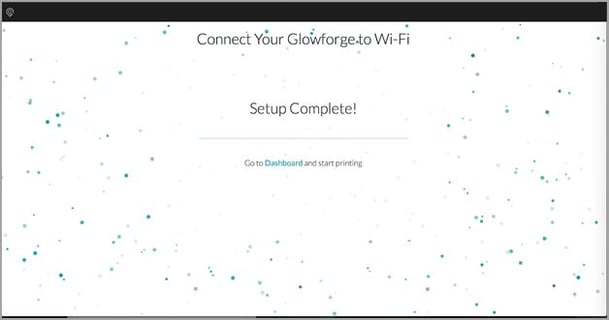

- When you see the message that you’ve connected to your network, wait a few more moments until you see the Setup Complete message. Congratulations! You're ready to start printing!
