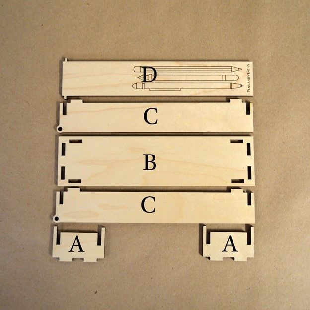

- Overhead photograph: Start with an overhead photograph of all your pieces.
- Arrange each piece just as they are positioned in the app (or in your printer before you take your print out).
- Clearly label each piece. These labels show your customers which parts are used in each step.

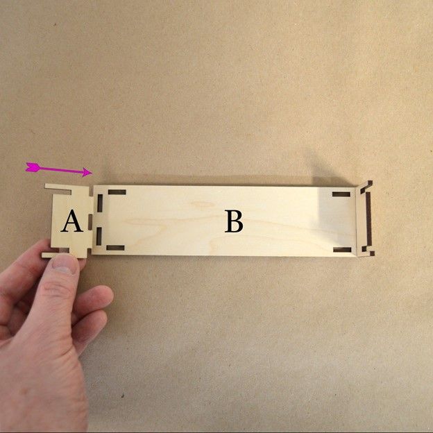

- Process photographs: For each step where your customer joins two parts, you should provide a photograph and description of what they need to do.
- Clearly label which parts your customer should be interacting with.
- Clearly show the action you expect your customer to take with the labeled parts. You can add a red arrow or a square for emphasis.
- For each process step, add a descriptive subtitle that explains what you intend your customer to do. For example: Firmly push both parts A into the end slots of part B as indicated.
- Position your phone or camera directly above the surface, looking straight down at the center of the action.
- Anything you write in words should be demonstrated in a photo. Most customers will rely more heavily on photos than on words.
- Watch for the shadows of your hands or off-camera things that might cast across your work surface.
- Crop each image so the action is centered. Keep the aspect ratio consistent at 1:1 or 4:3.
- Add arrows or other indicators to help your customer understand what they are expected to be doing. We recommend using Preview or Adobe Illustrator to mark up the photos.
