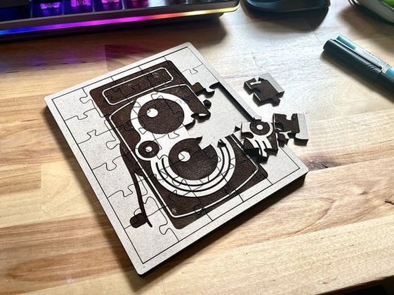

When you use Puzzle Maker, exclusive to Glowforge Premium, you can easily turn any piece of art into a puzzle with just a few clicks. Create puzzles out of engraved photos, or challenge yourself to create an original design.
Whatever design you chose, Puzzle Maker turns your design into an activity that anyone can enjoy.

Now print and puzzle! With Puzzle Maker, you can go from idea to finished puzzle in minutes.
