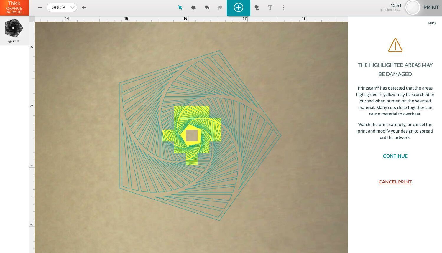

One of the things that makes your Glowforge special is its smarts. Our cloud computing service works to predict if your design might not print the way you intended. We call this system Printscan™.
Printscan can help you avoid charring, discoloration, and material damage when working with intricate designs. If, for example, your design has a lot of cuts in a small area, you might see a warning that says THE HIGHLIGHTED AREAS MAY BE DAMAGED.
You’ll see it after you press Print in the app, but before you’re prompted to press the glowing button on your Glowforge. The App will highlight areas where the design concentrates a lot of laser energy.
It looks something like this:
A screenshot of the Glowforge App. On the right-hand side is a warning about material damage. The specific area of the design that may damage material is highlighted.
If you see this warning and press the Print button without changing your settings (or your design), you might get charring, discoloration, or material damage. You should double-check your settings and your design. For example, you might have double lines, or tiny lines you can remove.
What to do
If you get a warning, you have a few options:
  • Continue your print.
    You can ignore the warning and print your design anyway, while watching especially carefully. Depending on the material you’re using, you might still get a beautiful print.
  • Cancel your print and try some changes to your design to see if they eliminate the warning. For example:
      • Modify your design. Check for duplicate lines and hidden overlaps, and delete them. Place cut lines further apart.
      • Try Proofgrade. Proofgrade settings and material are less likely to cause issues, and Printscan was designed to work best with them.
      • Change material. Printscan takes your material into account when analyzing. A design that causes problems on thin leather may be just fine on 1/4" plywood.
