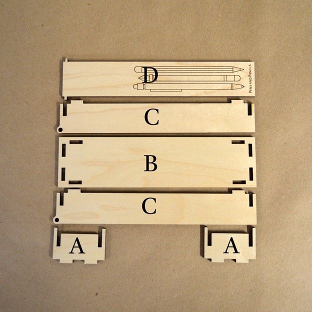

Step 1: Gather and identify your pieces
Laser cut parts for a wooden pencil case, labeled A through D

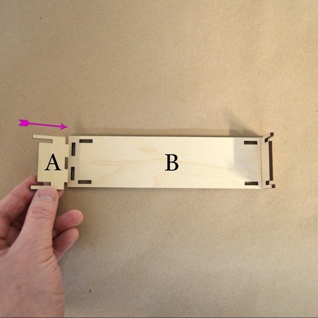

Firmly push both parts A into the end slots of part B as indicated.
Two hands connecting wooden laser cut parts labeled A & B

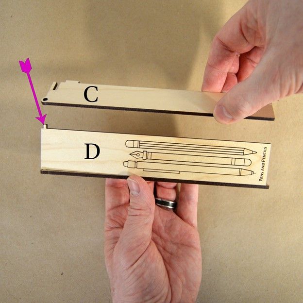

Step 3: Assemble the sides and lid
Insert the tab on part D into the hole in part C.
Two hands connecting wooden laser cut parts labeled D & C

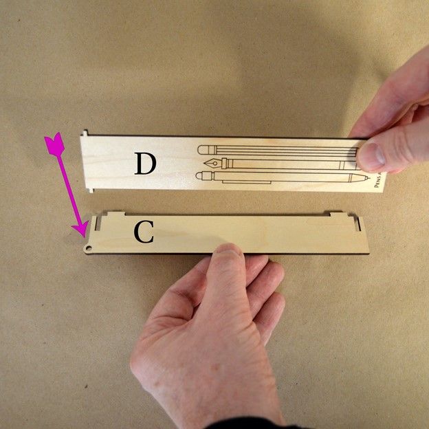

Step 4: Put it all together
While holding the assembly, insert the other tab on part D into the hole on the other part C.
Join the two assemblies together by sliding the slots of both assemblies together as indicated and sliding the tabs into the holes firmly.
Two hands connecting wooden laser cut parts. The tab on part D is going into the hole on part C

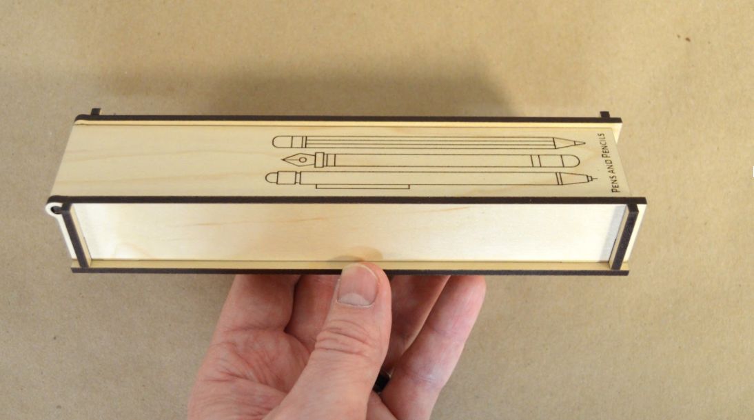

Gather your pens and pencils together and enjoy!
a hand holding a completed, laser cut wooden pencil case
