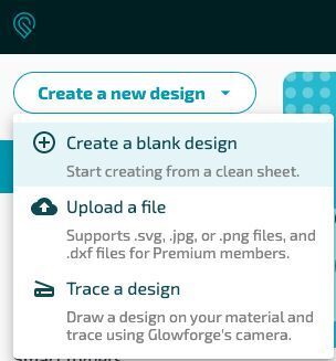

  3. On the Dashboard, click Create a new design, and then click Create a blank design.
    Screenshot of the create a new design & create a blank design buttons in the Glowforge App

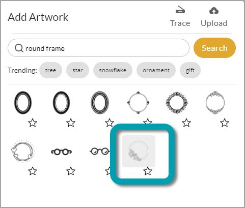

  5. In the search box, type “round frame,” and then click Search.
  6. In the search results, select the frame with the flower design on the bottom left of the circle.
    Screenshot of the Glowforge App showing selecting floral frame clipart
    Note: It takes a moment for the artwork to be imported to the workspace.
