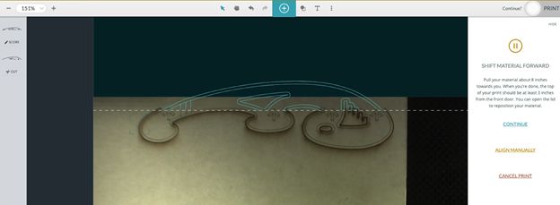

- Place a sheet of Medium Draftboard into the Pro Passthrough slot longways. Be sure to support the section protruding from the printer, so the material lies flat inside the printer.
- Double-check that the material lies completely flat against the crumb tray. Press gently on the material where it rests on the tray. If it’s flat, it shouldn’t move.
Note: It can help to use pins to hold the material flat. Some customers use small pieces of scrap to print these pins (available in the free laser design section). - On your Dashboard, open the Smooth Curves Stencil design.
- In the workspace, open the three-dot More menu, and make sure Pro Passthrough is turned on.

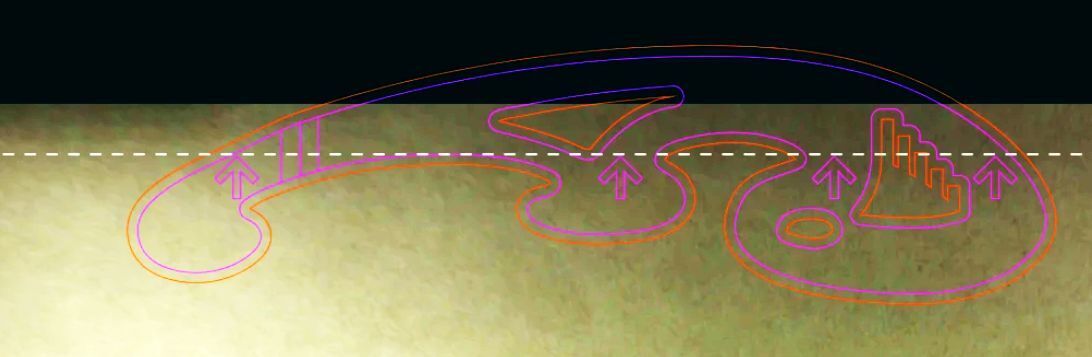

- Select the entire design, and arrange it so that the tips of the arrows touch the dotted line at the top of the work area, as shown below.
- Place your material on the printer bed, and select the type of material in the top left.
- Click print and run the first section of the design.
- After the first section completes, your Glowforge will inspect the design and take pictures to help with the alignment in the next step. Please do not move your material or open the lid until prompted by the onscreen instructions.
- After your Glowforge has taken the pictures, follow the onscreen instructions and move your material through the Pro Passthrough slot so the printed area is more than 3 in (7.6 cm) away from the front.
- Follow the prompts and run the 2nd portion of the test print.
