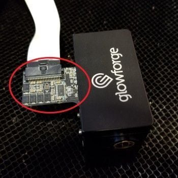

Push down fully on the wire ribbon tab, then gently unplug the wire ribbon from the printer head.

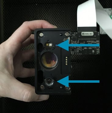

Take a clear photo of the gold-pin connector on the printer head, where you just unplugged the wire ribbon. Take a second photo of the the bottom of the printer. (See examples below.)
Holding only the finished black surfaces of the printer head, pick up the printer head and wire ribbon.
- Make sure the tab on the wire ribbon is facing up. Slide the ribbon into the head until it clicks.

As shown, lower the printer head over the metal plate so that it rests next to the two round posts. Then push it gently away from you – you’ll feel a click as magnets pull the printer head until it sits snugly atop the metal plate.

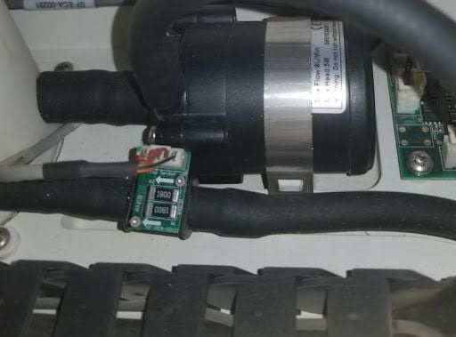

Pull the laser arm all the way forward. Take a clear photo of the circuit board on the inside left of your Glowforge. Please make sure to include the white ribbon connection highlighted by the arrow in the example below.
- Just to the left of the large circuit board is a small green circuit board. Take a photo similar to the example below:

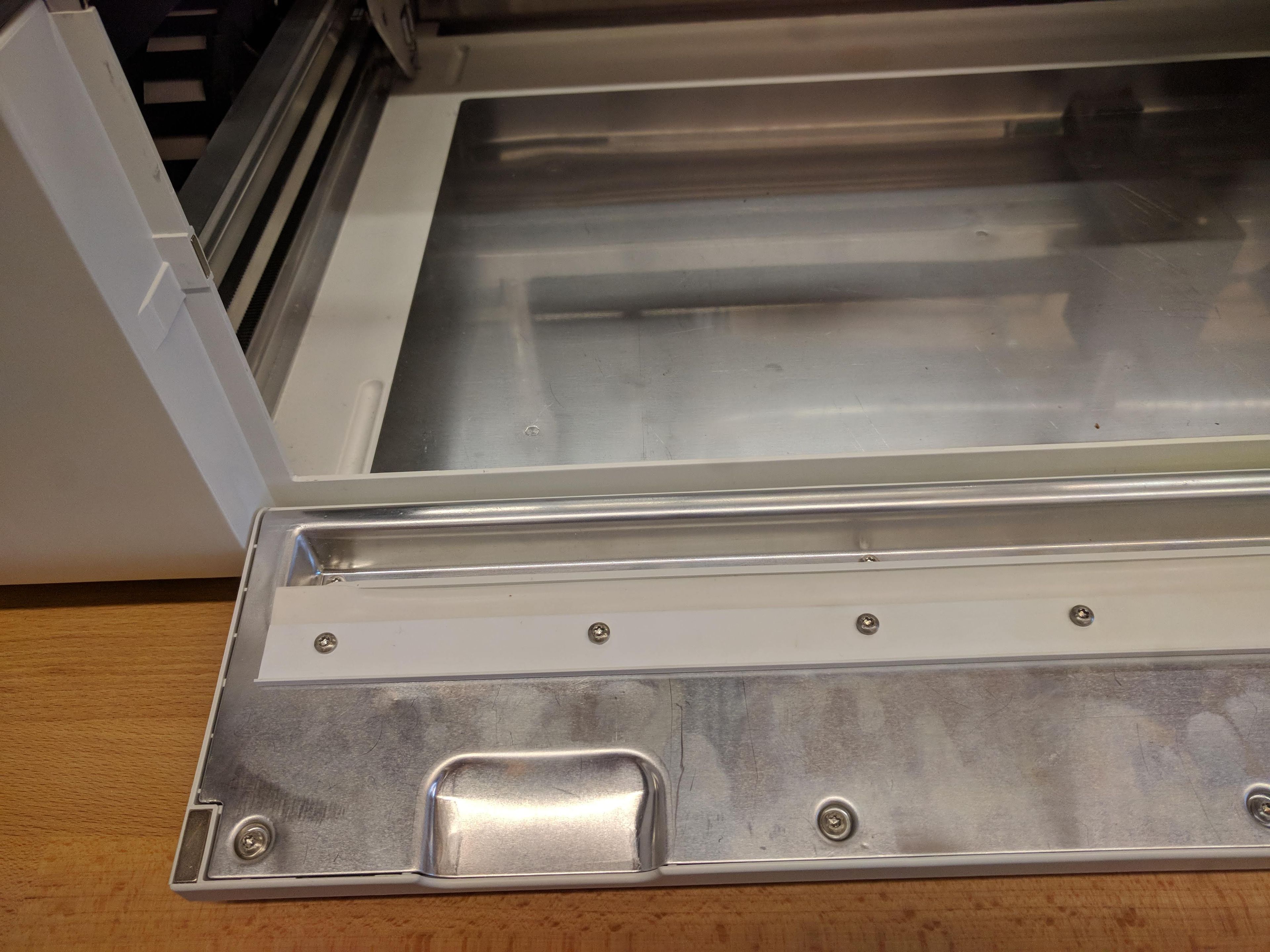

- Take a photo of the left, inside of the front door. See below.

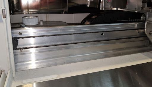

Take a photo of the left side rail. See below.
- If the cable in step 10 above, marked with a red arrow in the photo, looks loose, please reconnect it and try printing again. This cable should 'click' back into place.
