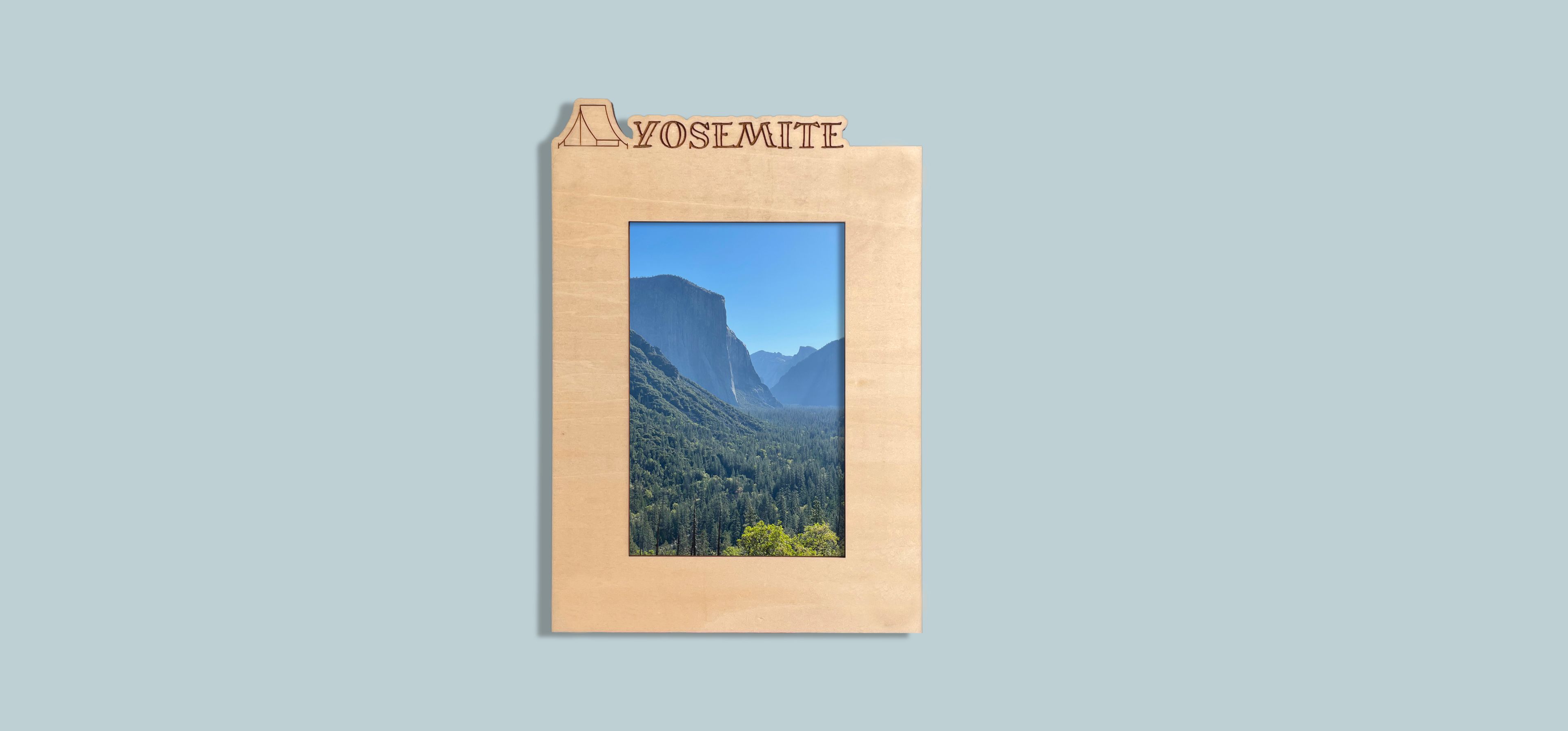

A completed, laser cut photo frame
In this tutorial, we'll show you how to make a custom photo frame. You'll use Proofgrade® Medium Plywood and the text, artwork, and outline features in Premium.

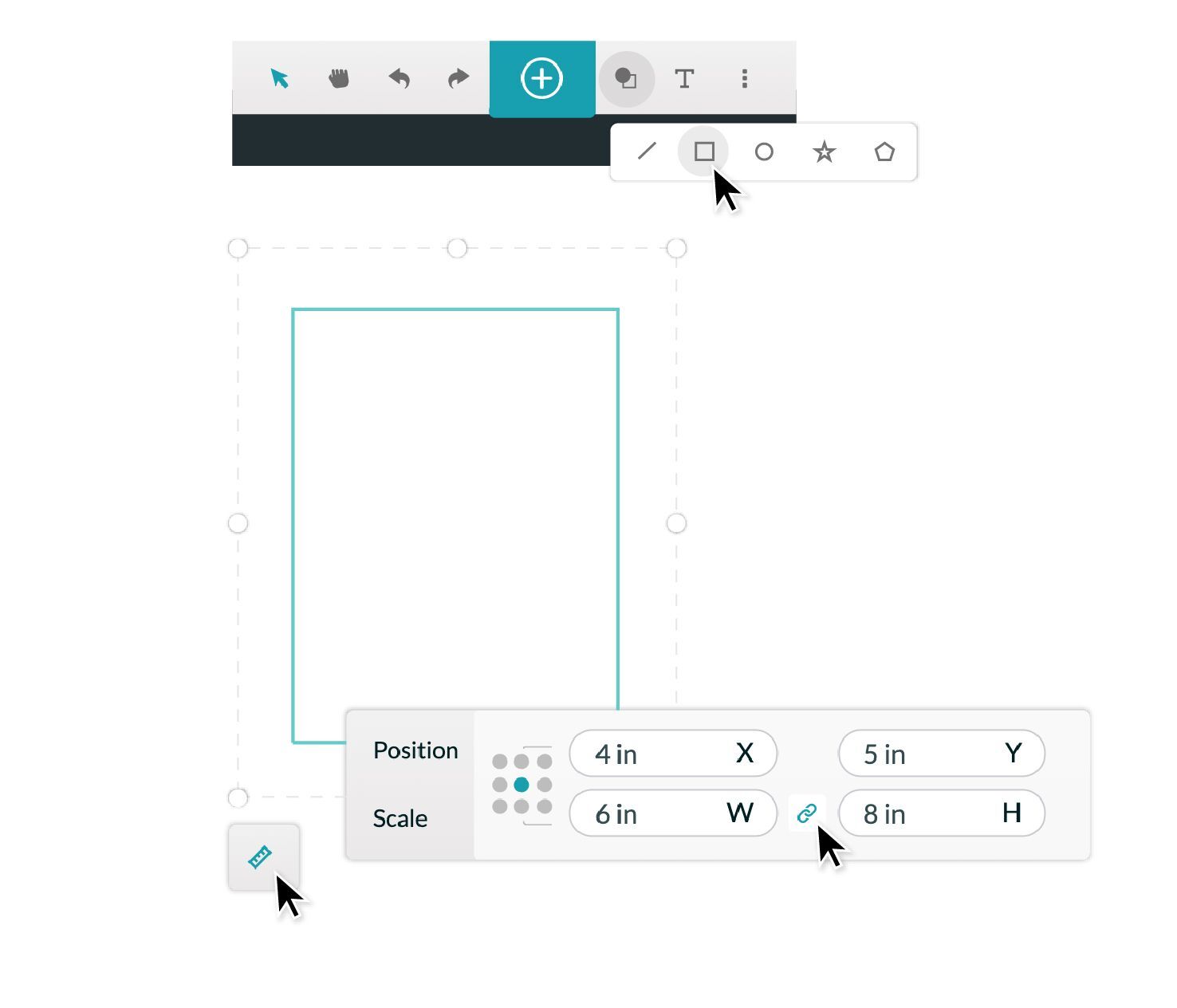

  1. You’re creating this design from scratch, so on the Dashboard, click Create a new design, and then click Create a blank design
  2. In the workspace, on the top menu bar, click Insert shape, and then click Insert square.
  3. Once the square appears in your workspace, click the ruler button (Reposition and resize selected artwork) in the bottom left.
  4. To add the dimensions you want, first make sure that the Lock aspect ratio is turned off. Click the chain button to change this option.
  5. In the Scale text boxes, set the length to 6 in, and height to 8 in.

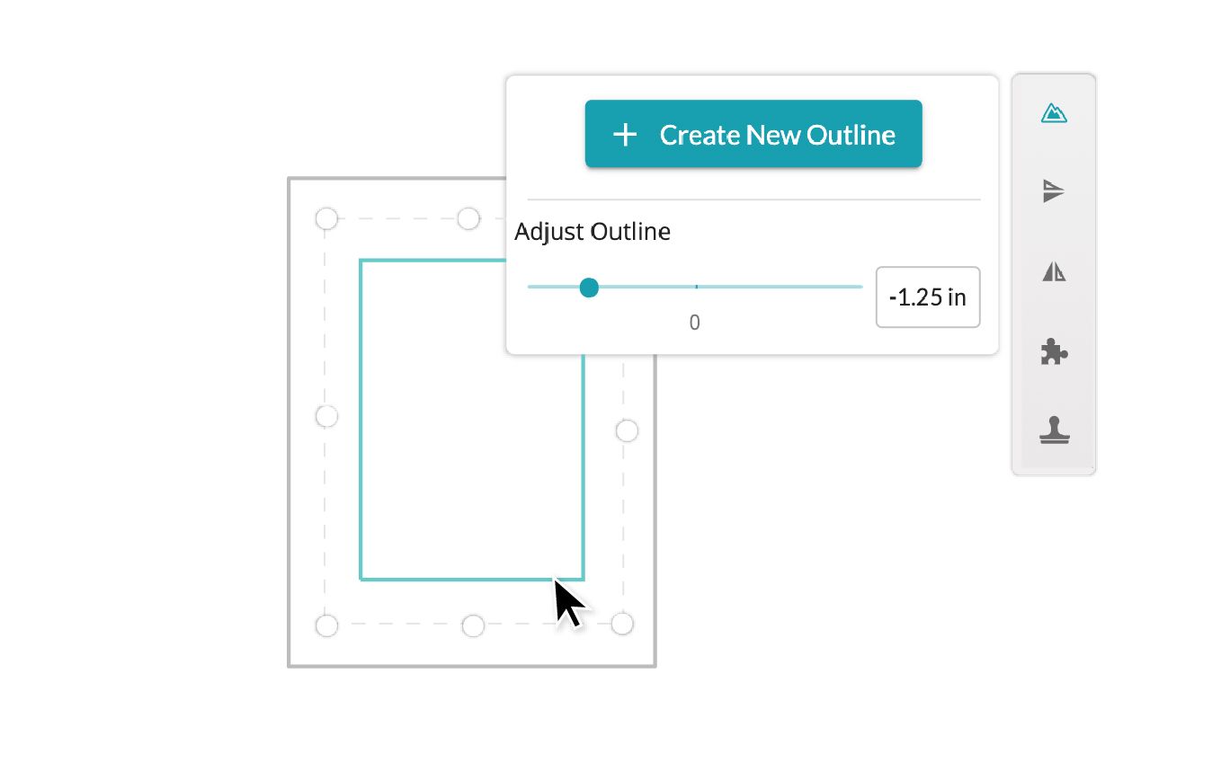

  6. To create the opening for your photo, click to select your rectangle, and then in the menu on the right, click Create outline.
  7. Click Create New Outline, and then move the Adjust Outline slider to -1.25 in.
    Tip: You can also type the outline setting in the text box.

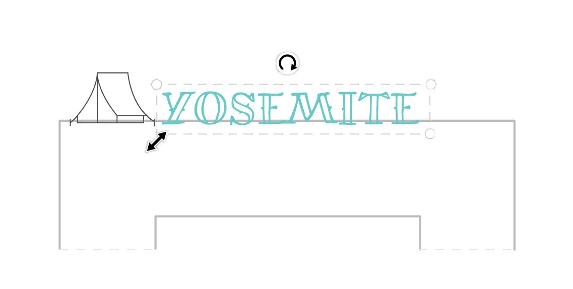

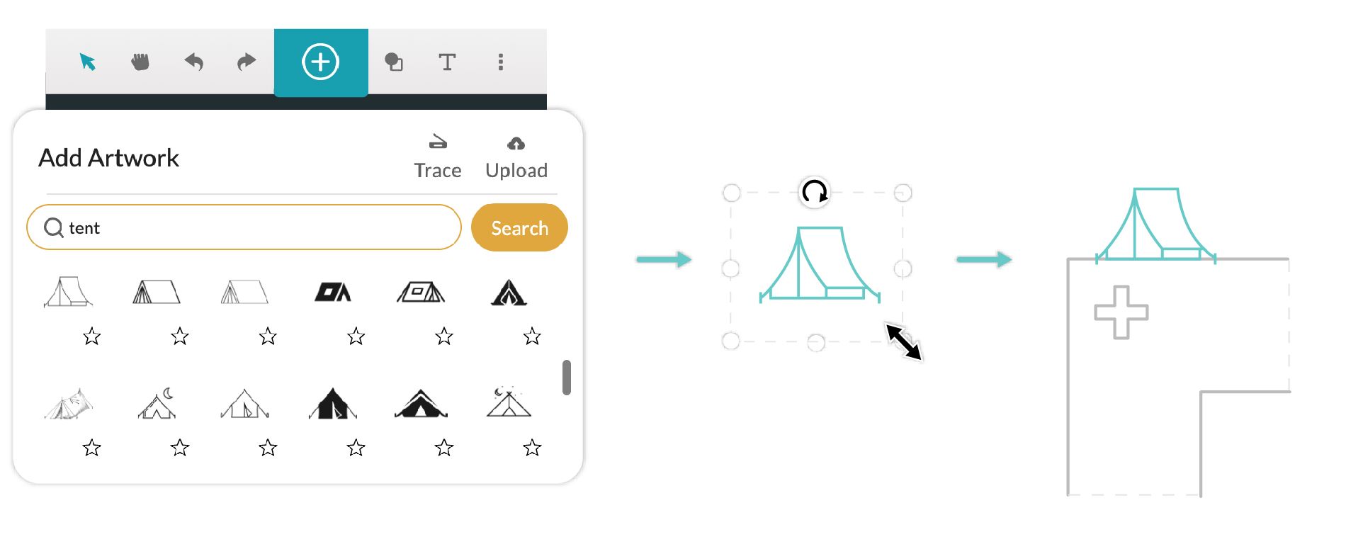

Now add some artwork to your design. For an endless supply of ideas, you can browse the featured artwork, search the 2 million+ images, upload your own designs, or trace hand-drawn artwork.
  1. For this project, on the top menu bar, click Import artwork.
  2. Search to find some art you like, or click one of the featured illustrations.
  3. Once the artwork appears in the workspace, click to select it. Resize or rotate your artwork however you’d like, then drag to align it to the top edge of the frame.
Tip: You can align this artwork however you want. It can be sitting on top of the frame or overlapping a bit. Later in the process, you’ll change and check some specific settings to make sure it prints the way you want.

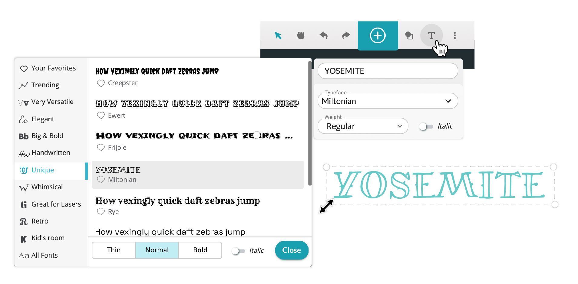

  1. On the top menu bar, click Insert text.
  2. In the text box, type the word or phrase that you want on your frame.
  3. Click the Font dropdown arrow, and then in the expanded font menu, choose what you want from all the options. For this project, we used the font Miltonian.
    Tips: To find the perfect font, you can browse the options by style grouping, or click All Fonts, and then search. You can also preview bold or italic variations for your font by clicking the options at the bottom of the expanded font menu.
  4. Resize or rotate your text the way you want it, and then align it next to your artwork at the top edge of the frame.
    Note: Be sure to overlap your text and graphic elements slightly with the frame.

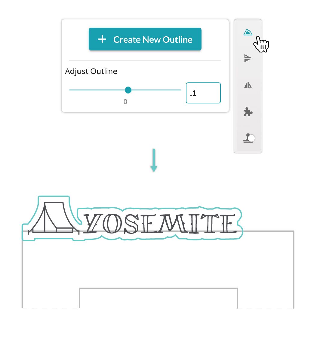

A screenshot of arranging text along a line in the Glowforge App Connect your text and artwork to the frame A screenshot of adding an outline around two selected objects in the Glowforge App

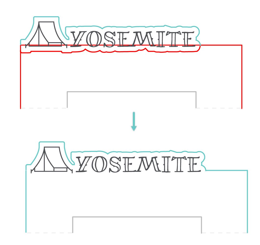

Now you’ll make a smooth connection of your artwork and text to the frame by using outlines.
  1. To create a selection box around all your art and text elements, click outside the design, and drag to include all the elements in the box.
  2. In the toolbar on the right, click Create outline.
  3. Click Create New Outline, and then adjust the outline to .1 in.  You now have a new outline for the shape of your frame that includes your art and text.
Delete what you don’t need A screenshot of deleting overlapping linesin the Glowforge App
Now that the frame shape is ready, before you print, you’ll need to remove a few spare lines that are no longer relevant to the design.
  • Click to select the original frame rectangle of the frame, and then press Delete on your keyboard.
Tip: If you happen to accidentally delete the wrong thing, you can easily undo your last action. Just press CTRL (or CMD on Mac) + Z.

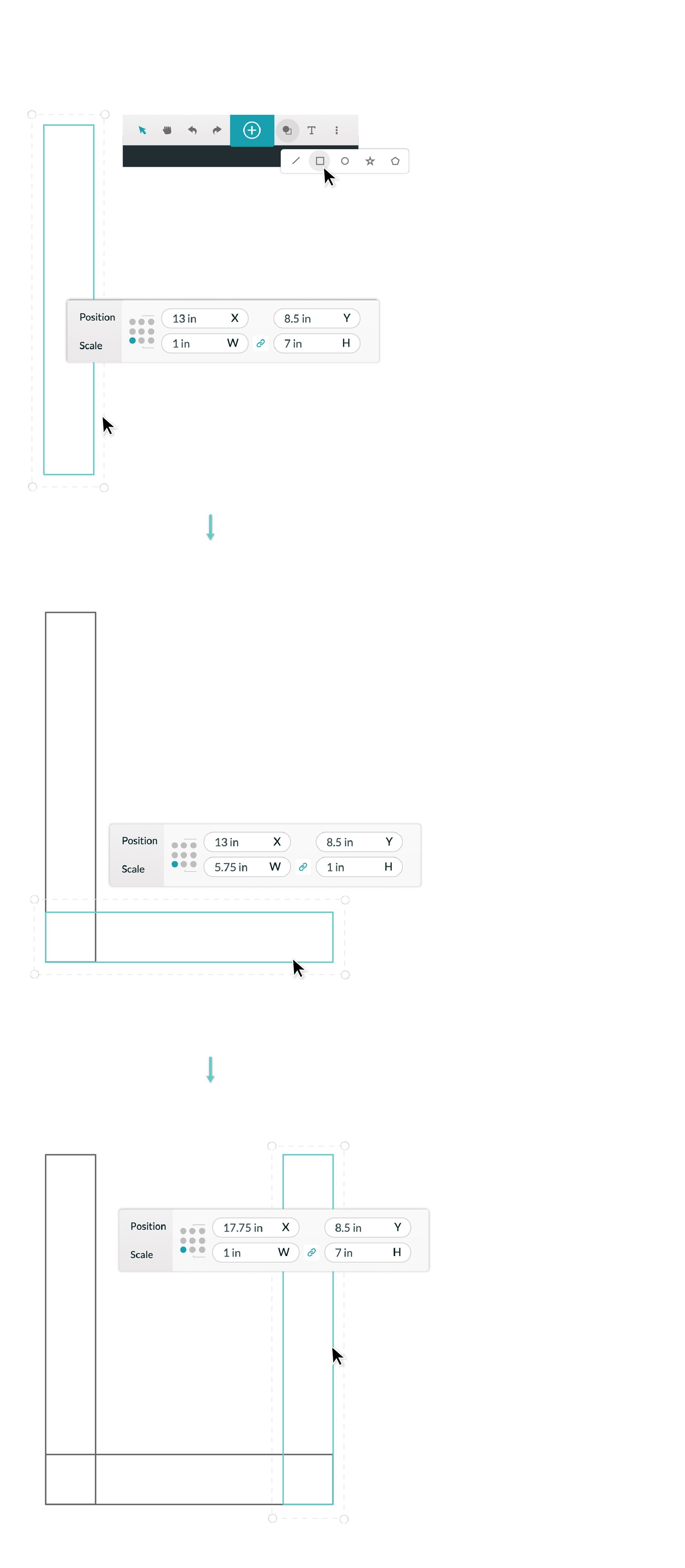

Finally, create a channel to hold the photo. You’re going to create three rectangles and join them to form a “U” shape.
Screenshots of making and arranging multiple rectangles in the Glowforge App
  1. Create a rectangle with a width of 1 in. and a height of 7 in.
    • In the precision position tool, click the bottom-left alignment dot. This tells the App which corner of your artwork or shape to use for alignment.
    • In the Position text boxes, set the X coordinate to 13 in and the Y coordinate to 8.5 in.
  2. Create another rectangle that’s  5.75 in. wide and 1 in. high.
    • In the precision position tool, click the bottom left alignment dot.
    • In the Position text boxes, set the X coordinate to 13 in, and the Y coordinate to 8.5 in.
  3. Create a final rectangle that’s 1 in. wide and 7 in high.
    • In the Position text boxes, set the X coordinate to 17.75 in and the Y coordinate to 8.5 in.
  4. Click and drag a selection box around all three rectangles.
  5. In the toolbar on the right, click Create outline, and then click Create New Outline.
  6. Set the outline to 0 in. This will join the shapes to the frame.
  7. Click on each of the original rectangles and delete each so that only the U-shaped outline remains.A screenshot of 3 rectangles that have been combined in the Glowforge App

Assemble your frame A screenshot of unassembled, laser cut parts for a photo frame.
  1. Glue the U-shaped channel to the back of the decorative frame with the opening facing up.
  2. Glue the frame assembly to the solid frame back.
  3. Slide your photo through the opening.
  4. Hang your frame from the wall, or consider printing the Elegant Artstand for a tabletop display.
Enjoy your frame and photo, and get ready to hear “I want one too!” from friends and family.
