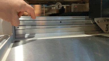

2. Remove the crumb tray and locate the pulley.
Open the front door and carefully remove the crumb tray. Without removing the belt, locate the black pulley fastened by a metal screw in the back of your Glowforge printer.
Locate the Pulley

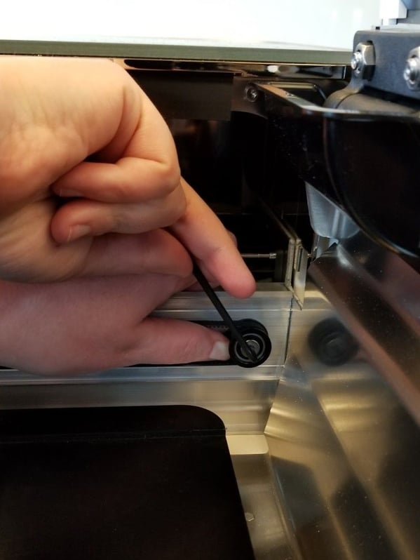

3.  Insert the hex key into the pulley
Insert the short side of the 3mm hex L-key into the metal screw with the long handle pointing toward the front of the unit.
Insert Hex Key Into Pulley
4.  Loosen the pulley.
Turn the key counter-clockwise to loosen the screw until the pulley can slide with some friction. Don’t remove the key from the screw.
5.  Slide the pulley to the back of the printer.
Using one hand, slide the pulley towards the back of the printer. It will take some force, the belt should be at full tension.
Slide the Pulley to the Right
6.  Tighten the pulley.
While keeping tension with your other hand, turn the hex key clockwise to tighten the screw in the pulley.
Tighten the Pulley
