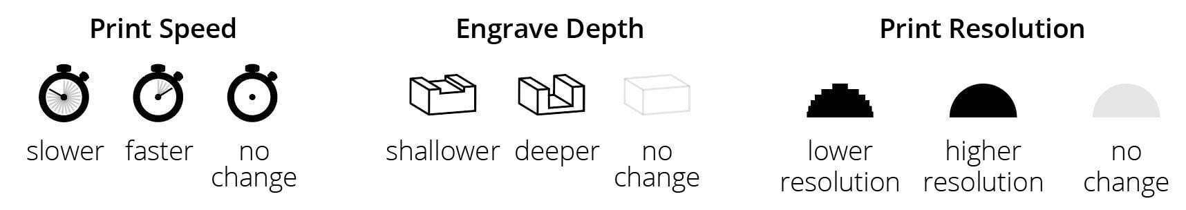

Legend
Three symbols offer a quick visual reference for each parameter's effects. "Print speed" refers to how quickly your print will complete; "engrave depth" refers to the depth of your engraves and scores; and "print resolution" refers to the level of detail achievable. Keep these in mind as you read further.

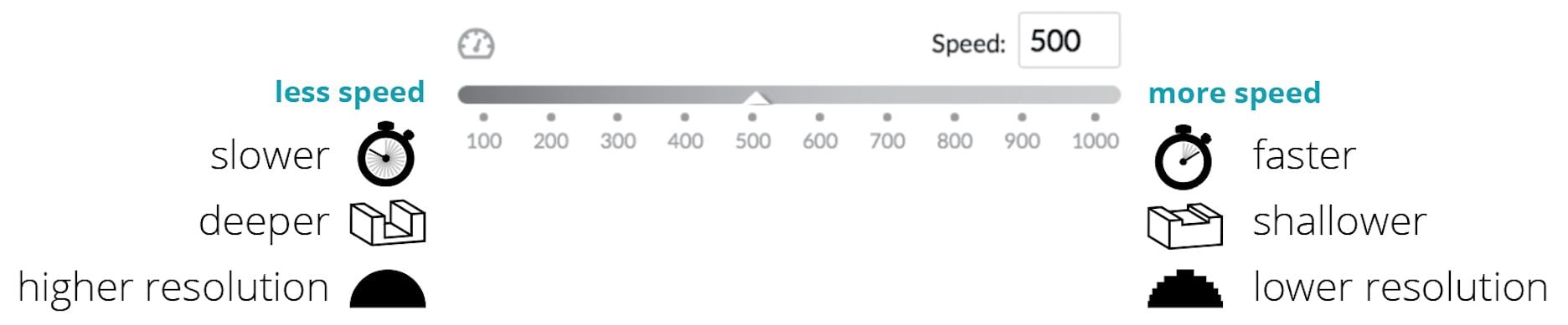

Speed
Speed controls the maximum speed the laser head moves around the printing area.
How does this affect my print?
  • Increasing speed decreases your overall print time, as the laser head moves more quickly.
  • Increasing speed decreases the depth of engraves, cuts, and scores, as the laser has less time to impart laser energy into your material.
  • Increasing speed reduces print quality. In the case of an engrave, the laser has less time to make an accurately positioned mark on your material. In the case of a cut or score, too much speed can result in the laser head jerking when changing direction, causing jagged lines and bumps in your print.
  • Too much speed when cutting and scoring can also result in dark corners when the laser head changes direction, imparting too much energy for the material.

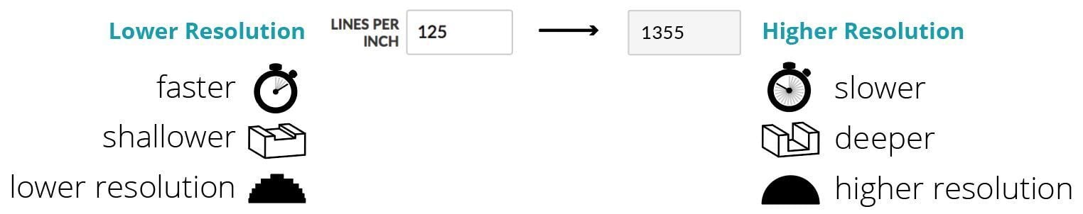

Engrave Resolution
Engrave resolution, or lines per inch, controls how many horizontal passes the laser head makes when engraving a design.
LPI
  • As the diameter of the laser spot doesn’t change unless modified using Focus Height, there are only so many spots that can fit into an inch of vertical space before there are gaps between them, or they start to overlap.
    • Using low Lines Per Inch (LPI) can results in stripes in an engrave, or jagged edges when engraving curved objects, as the laser spot barely, or doesn’t overlap.
    • High LPI causes the laser spots to overlap, smoothing the appearance of engraved shapes.
    • Using high LPI also causes engraves to be deeper. This is caused by the laser passing over the same spot more than once, and removing material each time.

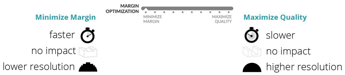

Minimize Margin (Beta)
Minimize Margin works for bitmap engraves only. When it is set to anything other than “Maximize Quality”, the engraving begins while the head is still getting up to speed.
Margin
  • The margins are the grey no-go zones on the left and right the head uses to travel up to speed. You can now opt to have your Glowforge start engraving while the head is still getting up to speed in the margin, and the software will automatically compensate by lowering the power.
  • By default, the option is set to “Maximize quality”. By changing it to minimize margin, the on-screen grey zone will shrink allowing for a larger printable area.
  • This can make your engraves much faster, especially at high head speeds! Because accelerating takes a while, engraving in the margins can drastically decrease the time it takes to print.
  • This feature is in Beta. It only works for bitmap engraves, not vector engraves. The edges of your engraving may look a little blurry or ragged at high speed and minimal margin.

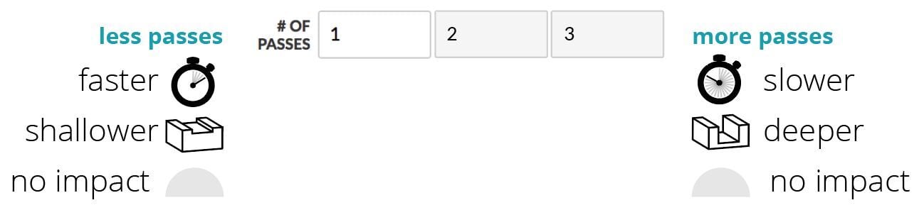

Number Of Passes
The number of passes controls how many time the laser repeats the entire engrave step.
  • When engraving, using more than one pass has a similar effect to using high LPI, and causes a deeper engrave. For intentionally deep and 3D engraves this is perfect, but in most cases, a single pass is all that’s needed.
  • When cutting, multiple passes may be needed to cut through thick non-Proofgrade material. The number of passes option makes this easy, and prevents having to run the print twice.

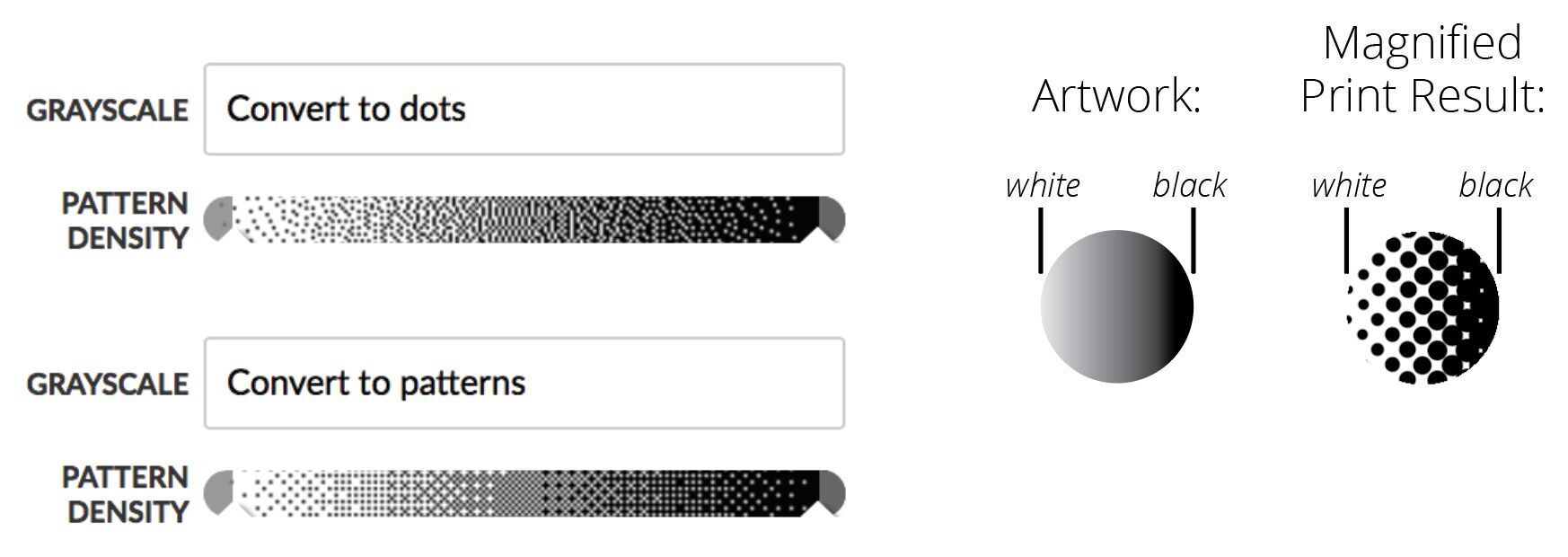

Grayscale - Dots and Patterns
Much like a newspaper print, using a grayscale option converts your artwork into a series of tiny dots. This is called dithering. The darker your artwork, the more dots that are produced and the more they overlap. The concentration and position of these dots translate visually into areas of white, gray, and black. The pattern density slider is key to getting a good result when using dithering and is explained in a later section of this tutorial.
Dots and Patterns
Convert to dots vs Convert to patterns Dots and patterns both translate your artwork into a series of tiny marks, but arrange these marks slightly differently.
  • Convert to dots arranges the marks in a way that appears natural and random. We find this works best for engraving curvaceous and organic images, such as photographs.
  • Convert to patterns arranges the marks in a much more orderly and structured way. This structure is sometimes visible and detracts from the quality of an engrave. You may find it works well for graphical images, such as images with lots of straight lines and edges.

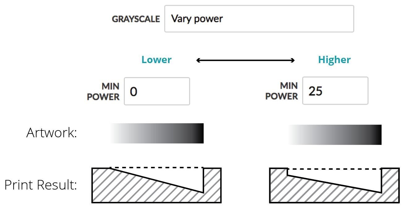

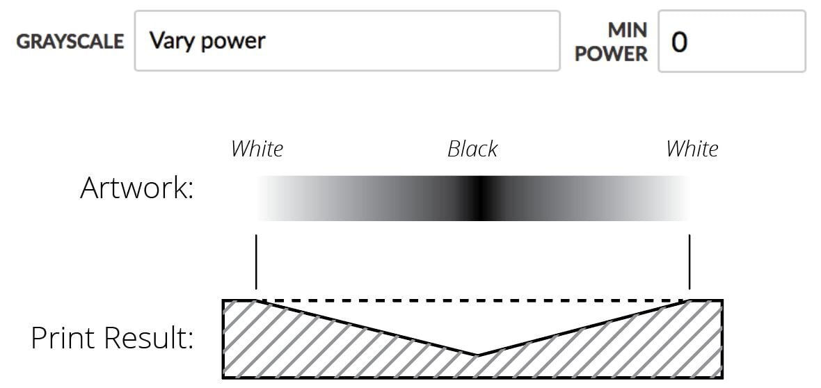

Grayscale - Vary Power and Min Power
The Vary Power and Min Power settings control the maximum and minimum amount of power used during an engrave, based on the color of the uploaded artwork, the power level set, and the Min Power level defined. In its simplest form, when Vary Power is enabled, the chosen power level controls the depth of the darkest parts of your artwork, and Min Power controls the depth of the lightest parts. Pure white pixels are ignored regardless of the chosen settings.
If we take a gradient of 1-100% gray as an example, enable Vary Power, and set the Min Power to 0, the Glowforge printer will apply 1% of the power level to artwork that is 1% gray, 5% of the power level to artwork that is 5% gray, and 100% of the chosen power level to artwork that is 100% gray.
Vary Power
Taking the same 1-100% gray gradient but setting our power level to 80, and Min Power to 20 results in the darkest parts of our artwork being printed at 80 power, and the lightest parts being printed at 20% of 80.
Min Power

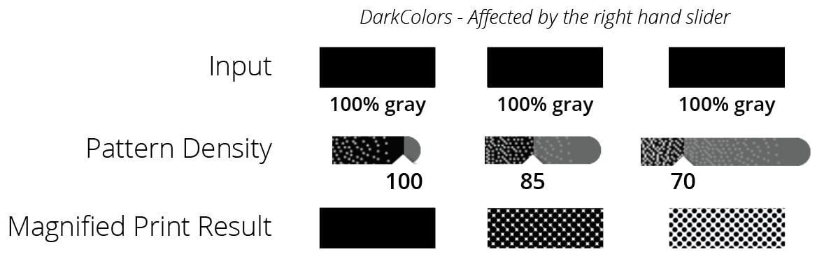

Pattern Density
In conjunction with dithering, the Pattern Density can be used to make the light areas of your image appear darker or deeper, and the dark areas of your image lighter and less deep. It’s a powerful tool, especially when engraving photographs.
Let’s assume we upload a photograph that includes both light and dark areas, and engrave it using full speed, 100 precision power, and Convert To Dots.
In this scenario, unless we have carefully processed our image to prepare it for engraving, we will likely find that the lightest areas in our image don’t make a mark on our material, and the darkest areas are very dark and deep, and may be merged together into a big brown blob.
If the lightest areas of our image don’t mark the material, increase the value of the left hand Pattern Density slider. This is somewhat equivalent to darkening the light areas of our image, which when combined with the Convert To Dots option, increases the concentration of dots within a given area, causing more of them to overlap, and visually translating to a darker print result.
PD Light
If the darkest areas of our image muddle together or are too deep, decrease the value of the right hand Pattern Density slider. This is somewhat equivalent to lightening the dark areas of our image, which when combined with the Convert To Dots option, decreases the concentration of dots within a given area, reducing the amount of times the dots overlap, and the depth of the engrave.
